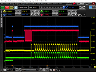

  • I can verify that have sufficient solder coverage to its thermal pad,because it soldered smoothly.Could you share your e-mail address, I can send you the sch and layout for detail. The chip's losing efficacy goes with temperature, before it loses efficacy, it works as a good one.But when in sick, Qualcomm will shut down the eng because of the ECC error.yellow is DA green is DB

    Is the issue only happening with temperature? At what temperature are you seeing the failure and does the failure go away when you bring the temperature back to 25C?
    David
    1. At an ambient temperature of 30°C , the Qualcomm platform continuously obtains dual camera images. After running for a period of time(tens of thousands of frames), the platform reported ECC error stop. Restart process, get a few frames of image and failed again.
    2. At an ambient temperature of 10°C, do the same thing as the first item above. The dual camera can run stably, and the test time is about 3 hours.
    3. At an ambient temperature of 50°C, do the same thing as the first item above. The process fails immediately and can not be repaired even retry.But when the temperature goes down to 10°C,it can be repaired again.

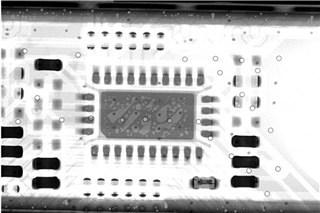

    Is it possible to get a x-ray picture of the DPHY440 thermal pad? Given that the issue is related to the temperature, I would look at the thermal pad itself.

    I confirmed the thermal solder coverage is meeting the requirement.
