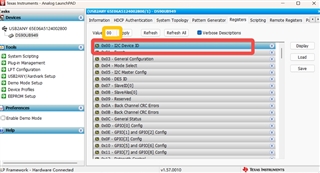

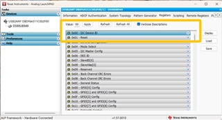

Here we can help you with technical questions. I may help identify the issue, why you can't read the I2C address if you provide me with screen shots from ALP main page.
If you want to return, you should contact your local TI representative, or the customers support on TI.com
are these the only two boards you have? or have you tested another boards and they work as expected?
Did you compare the jumpers settings and make sure these match the working boards?
