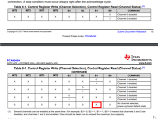

Hello E2E Experts,
Good day.
The Rev E datasheet for PWR9545A (March 2021) shows what appears to be TYPO (mistake) in Table 8-1.
See Bit B1, for the "No channel selected" case. The datasheet shows it as an "X". It should be a "0".
Earlier Revs of the datasheet show it as a 0.
Unless it means that on power-up, that bit may be a 0 or 1?
Please clarify.
