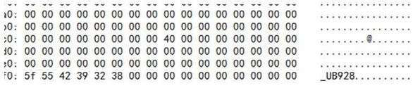

Our customer used the host side with i2cdump command to read the TI924Q information, found that the model number is 928, please help confirm, thank you!

Hi Kailyn,
How are you dumping the registers? Through ALP or through another method? What registers is this info being found?
Please re-dump the registers either with the same method or, if possible, with ALP, and see if the same information appears.
Additionally, please check the top marking of the device and confirm whether it is a 924 or 928.
