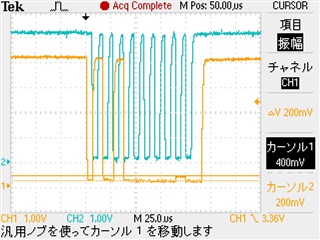

    The following waveform was observed, but would it be explainable if the DDC master side is push-pull?
    When connecting following the Figure 8-5 in the datasheet, with the DDC buffer enabled,LV side waveform:
    ch1 is SDA,ch2 is SCL.

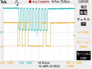

    At the same time on HVside waveform:

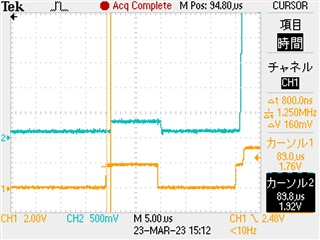

    Compare with LV side and HV side SDA NAK-like signal riseup timing:

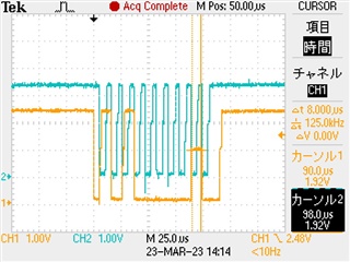

    now ch1 is LV side SDA ,ch2 is HV side SDA.
    Close up:
    It seems that the LV side SDA is 800ns faster than the HV side SDA.

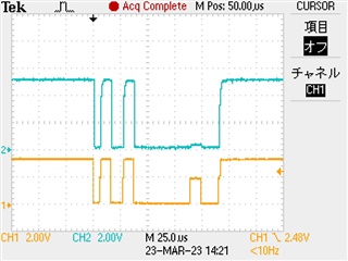

    The waveform when DDC buffer is disabled in the situation where following the Figure 8-5 in the datasheet for the connection,
    LV side waveform:

    The TDP1204 has integrated pullups to VIO on the DDC LV pins. Therefore, no external pull-ups shall be present between the TDP1204's DDC LV pins and DDC host when using TDP1204's DDC buffer.
    If you look at the waveform, when HV side falls first and goes below 1.6-V, a CMOS hysteresis input buffer detects the falling edge, turns on the LV driver, and pulls LV down to approximately VLVOL = 0.16 × VIO. With VIO being 3.3V, the VLVOL will be 0.528V. But with the internal 100k pullup on SDA, the scope waveform shows the SDA being pulled up to 1.7V.
    So I believe you need to use an external DDC buffer and following the connection as shown in Figure 8-6 of the TDP1204 datasheet.
