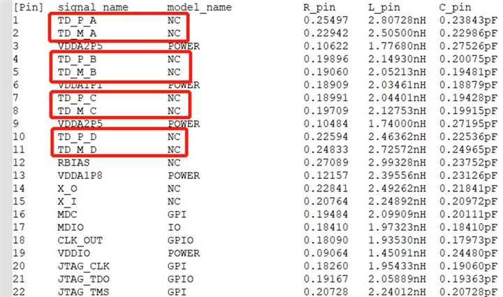

Dear sir,
would you please share the right DP83867IR IBIS file with me?
Customer feedback that the DP83867IR IBIS which downloaded from TI.com is not right. as following,
DP83867IR IBIS Model (Rev.A) - SNLM191A.zip
Jack
Hi Jack,
What do you mean by right file? We do not include MDI signaling on IBIS models due to the complexity of the signaling.
Sincerely,
Gerome
Hi Gerome,
Customer plan to use the IBIS file to do SI simulation of the TX/RX RJ-45 link path in ANSYS, but DP83867IR IBIS Model (Rev.A) - SNLM191A.zip doesn't work, you can find that the mode name of TD_P_A/B is NC.
Can you help on it?
Jack
Jack,
We do not model MDI nor XI/XO pins on our IBIS models. Only thing customers can model with IBIS is our MAC pins, and digital pins.
