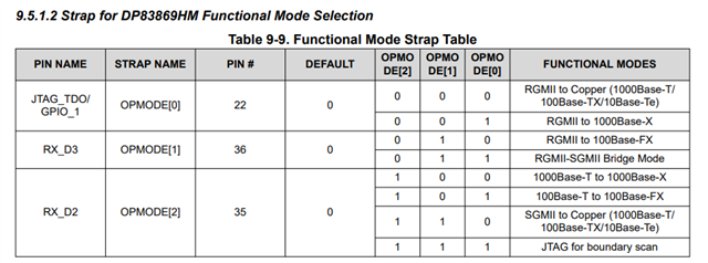

    And also, I would like you to confirm functional mode of EVM.
    If your EVM setting is different from "RGMII to 1000Base-X", could you please confirm result after changing strap pin to "001" ?
  • Hi Machida,
    Yes, 0xC should be 0xC00. And yes, pin 22 should be pulled high while pins 36 and 35 can be left without strap or be pulled down.

    Thank you for your reply.
    So, did you confirm that address 0x1df show 0x41, right ?
    (I wonder why 0xC00 shows 0x140 on your previous thread. Because default value both address 0x0000 and 0xC00 is same value 0x1140.)
    I think that customers phenomenon may happen only when this device is set as "1000Base-X" fiber mode.
    So, I asked this.
    I will need to check this in lab. Please expect a response by next Wednesday at latest.
    Sincerely,
    Gerome
    When strapped into RGMII to 1G Fiber, Register 0x1DF shows 0x0001. Upon further review, it has been determined that [6] is not relevant to device function for this mode. We will look to correct this in next datasheet revision.
    While strapped into this mode, 0xC00 read out 0x1140.
