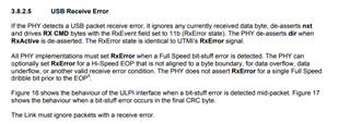

1 ) If PHY receive, RXError how to resolve it ?

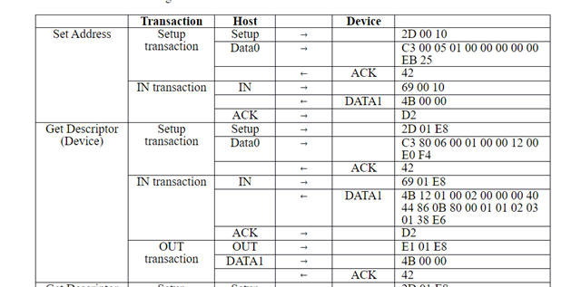

yes , sometimes I can see. but as u can see my waveform from FPGA,
2D0010 --> C38006000100004000DD94.
in this case DATA0 is C3 80 06 ....

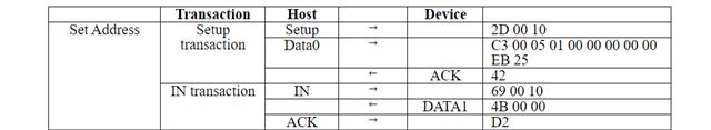

but I think should be
Data0 |
C3 00 05 01 00 00 00 00 00 EB 25
in this case, DATA0 is matched.
My question is Why PHY send out different DATA0 ?
How can I obtain DATA0 from PHY ?

With that, I can check board design something.. but as u can DIR always high in my case ( it mean there are errors.. but why ?
which error? how to resolve ? how to clear it ?
