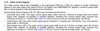

DS90UB947-Q1 doesn't support SSC (spread spectrum clocking). However, UB947 datasheet shows OpenLDI INPUTS Input Total Jitter Tolerance is 0.2UI max.
Customer use 40M OLDI clock. 0.2UI = 0.2* 12.5ns=2.5ns
Now customer SoC can send 40MHz with 0.25% spread. This is 25ns*0.25% variation which looks within our jitter requirement.
But Now UB947+UB948 always unlock with this 0.25% spread.
Is it normal?
