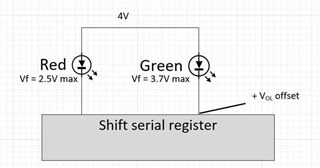

I'm looking at a use case like this:
Two questions that come to mind:
1) what would be the maximum current sink? Other newer devices have a "max ground pin current" spec or something and I can't find that for this device. Curious if the 25mA is per GPIO or total for the device.
2) If the highside 4V is higher than the device's supply, will the device continue to sink current? I believe yes per:
https://e2e.ti.com/support/interface-group/interface/f/interface-forum/1070800/tca6418e-gpio/3963241?tisearch=e2e-sitesearch&keymatch=TCA6418E%20current#3963241 "The device by default starts up with all GPIO ports configured as inputs with a 50 kΩ pull-down"
Happy to give more background on the use case if you have a small chip you'd recommend. Pretty sure this guy ain't it. Customer previously used a few NPIC6C596ABQ as a lowsides for 112 LEDs. The enable pin is used for PWMing. That part is now NRND.
I've been scanning our LED portfolio and logic portfolio for solutions, so far the top contenders seem to be 7x TLC59283 (LED) or maybe 16x TCA6507 with a bunch of I2C switches like TCA9548A
