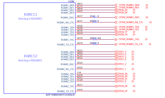

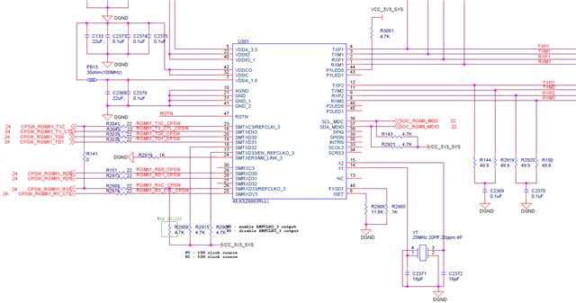

  • Dear TI ,
    LAN switch : ksz8863
    k3-am62x-sk-common.dtsi :

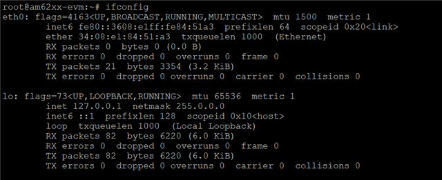

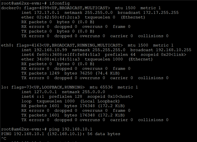

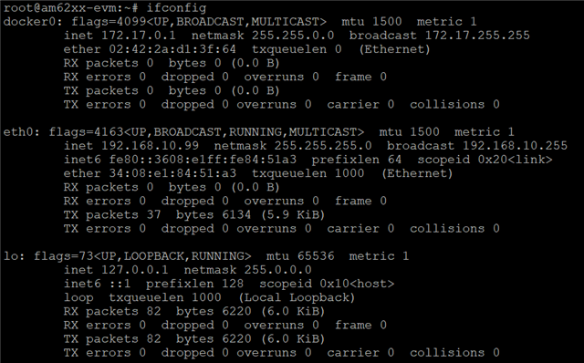

    ifconfig eth0 192.168.10.99
    My computer ip : (ping 192.168.10.1 )
    in my AM62x device ,run command as follows :
    ping ping 192.168.10.1
    test result : It can't ping successfully .

    Can you give me the output of these commands:
    • just after booting -> dmesg | grep cpsw
    • fconfig -a
    • k3conf dump rm

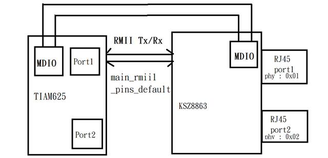

  • Dear  Rimika ,
    Update new status:
    (1) Plug in ethernet cable to connect eth0  and  network hub . (AM62x eth0 ==> ksz8863 port1 :  phy id : 0x01) . ping 8.8.8.8 is OK .
    (2) Plug out  ethernet cable to disconnect .
    (3) Plug in ethernet cable to connect eth1  and  network hub . (AM62x eth1 ==> ksz8863 port2 :  phy id : 0x02) . ping 8.8.8.8 is failed .

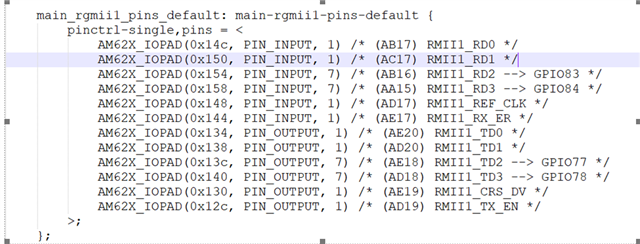

    Please refer to my device tree :
    &cpsw3g {
    pinctrl-names = "default";
    pinctrl-0 = <&main_mdio1_pins_default
    &main_rgmii1_pins_default>;
    status = "okay";
    &cpsw_port1 {
    phy-mode = "rmii";
    phy-handle = <&cpsw3g_phy1>;
    status = "okay";
    &cpsw_port2 {
    phy-mode = "rmii";
    phy-handle = <&cpsw3g_phy2>;
    status = "okay";
    &cpsw3g_mdio {
    cpsw3g_phy1: ethernet-phy@1 {
    reg = <1>;
    cpsw3g_phy2: ethernet-phy@2 {
    reg = <2>;

    [    7.998003] am65-cpsw-nuss 8000000.ethernet: down msc_sl e0000000 tmo 0
    [    8.058777] am65-cpsw-nuss 8000000.ethernet: set new flow-id-base 19
    [    8.086444] am65-cpsw-nuss 8000000.ethernet eth0: PHY [8000f00.mdio:01] driver [Micrel KSZ886X Switch] (irq=POLL)
    [    8.086467] am65-cpsw-nuss 8000000.ethernet eth0: configuring for phy/rmii link mode
    [    8.088777] am65-cpsw-nuss 8000000.ethernet eth0: Link is Up - 100Mbps/Full - flow control rx/tx
    [   11.905368] PVR_K:  996: RGX Firmware image 'rgx.fw.33.15.11.3' loaded
    [   11.932525] PVR_K:  996: Shader binary image 'rgx.sh.33.15.11.3' loaded
    [   23.224482] Initializing XFRM netlink socket
    [   24.266325] bridge: filtering via arp/ip/ip6tables is no longer available by default. Update your scripts to load br_netfilter if you need this.
    [   24.293729] Bridge firewalling registered
    [   25.286776] process 'docker/tmp/qemu-check386766029/check' started with executable stack
    [   29.596929] am65-cpsw-nuss 8000000.ethernet eth0: Link is Down
    [   31.644772] am65-cpsw-nuss 8000000.ethernet eth0: Link is Up - 100Mbps/Full - flow control rx/tx
    [   43.932967] am65-cpsw-nuss 8000000.ethernet eth0: Link is Down

    [    7.869344] am65-cpsw-nuss 8000000.ethernet: down msc_sl e0000000 tmo 0
    [    7.900829] am65-cpsw-nuss 8000000.ethernet: set new flow-id-base 19
    [    7.923910] am65-cpsw-nuss 8000000.ethernet eth1: PHY [8000f00.mdio:02] driver [Micrel KSZ886X Switch] (irq=POLL)
    [    7.944530] am65-cpsw-nuss 8000000.ethernet eth1: configuring for phy/rmii link mode
    [    7.983322] am65-cpsw-nuss 8000000.ethernet: down msc_sl e0000000 tmo 0
    [    8.027205] am65-cpsw-nuss 8000000.ethernet eth0: PHY [8000f00.mdio:01] driver [Micrel KSZ886X Switch] (irq=POLL)
    [    8.027228] am65-cpsw-nuss 8000000.ethernet eth0: configuring for phy/rmii link mode
    [    8.032786] am65-cpsw-nuss 8000000.ethernet eth0: Link is Up - 100Mbps/Full - flow control rx/tx

  • Hi Albert,
