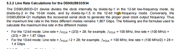

The PCLK is 96 MHz, and should be close to the calculation in the figure above, meaning that the communication becomes unstable after the transmission frequency on the coaxial cable rises from 1.4 Gbps to 1.8 Gbps.

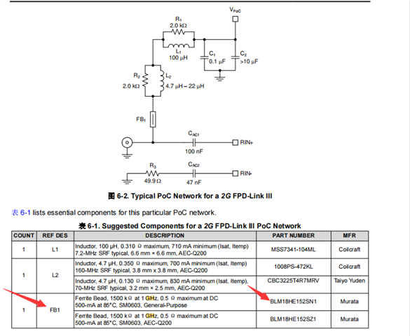

The customer then discovered that it could be due to FB1. The customer uses the reference design recommended in 934 and the device used is the same as in the 934 manual.

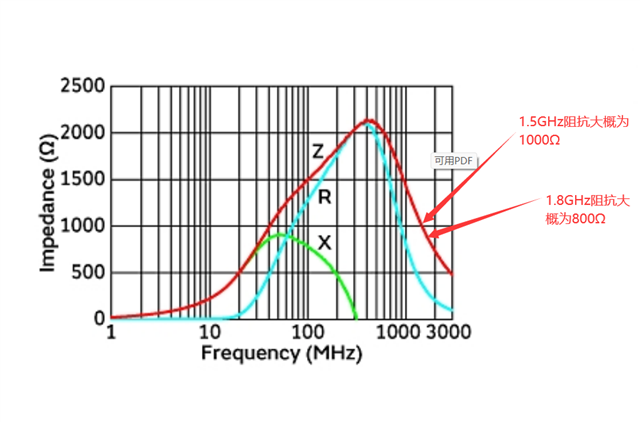

Customer try to connect a bead in FB1 in parallel, and VSYNC is much more stable than if it is not in parallel, but it still fluctuates and will fluctuate around 1 minute. According to the Bead Book for FB1, its impedance frequency curve is as follows:
So the customer wants to confirm whether replacing the beads can stabilize the communication? For example, at 1.8 GHz, replace beads with impedance greater than 1000 Ω.
    Can you clarify what you mean when you say communication becomes unstable? Do you mean that the lock between 933 and 934 becomes unstable?
    Since we only validate the recommended networks we provide, they will have to confirm this themselves and make sure that it meets our POC and channel requirements.
