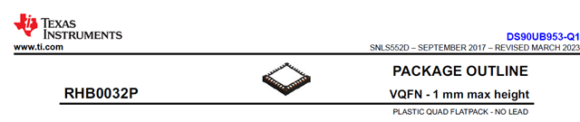

I find that in the datasheet of DS90UB953-Q1, there are two different packages: RHB0032P and RHB0032U
Could you please help to explain the difference between RHB0032P and RHB0032U?

Hello Jeff,
I can't see any "RHB0032U" in the datasheet. Can you tell me where do you see that?
Hi, Clemens
There are only two part number on the 953 specification, and it seems that only the package Qty is different.
Are these two both RHB0032U?
Thanks & Best Regards
Jeff
There are two manufacturing sites. But it would not make sense to not guarantee that you can buy devices with wettable flanks. If I'd have to guess, I'd suspect that all devices are RHB0032U, and that the package information in the datasheet is outdated.
