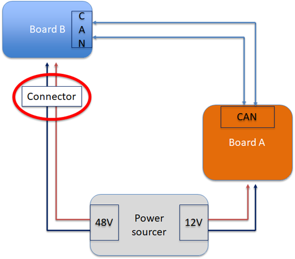

Hi Team,
As customer feedback, there is a connector between the cable from the power source to board B due to the long distance.
Once the connector aged and the GND pin maybe cannot connect firmly, the CAN on board A or board B will damage.
If they use individual power sources for both boards, there will not have the issue.
May I know how to fix the issue?
Is it helpful to use a higher common mode voltage range CAN solution?
