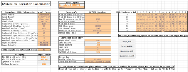

Please do not use the DSI Tuner SW for DSI86, you can use this spreadsheet to generate the DSI86 registers programming values.
David
Can you share your spreadsheet? DSI_CHA/B_HACTIVE_LENGTH_HIGH and LOW should be 1440.
David
David
Hi David,
I use DSI Tuner tools to make the screen work properly. Using this spreadsheet causes the screen to not work properly.
Fill in the C14 of spreadsheet "Vertical Blanking (lines)=37" and calculate 0x36 as 0x0B, which is wrong, correct should be 0x25, and DSI Tuner calculated it as 0x25, which is correct.

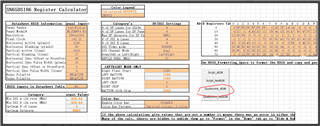

Can you help me generate Qualcomm_ASSR code to compare the differences between our codes
Thanks!
You can click on this button, and it will generate the Qualcomm ASSR text file Window Documents folder.
David
