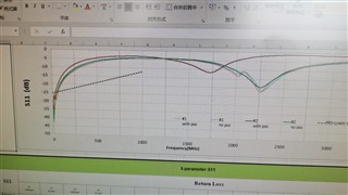

Customer is using DS90UB960-Q1 with below POC circuit, when making the test, the signal loss is poor. Can you help to check if any issues and how to improve it?
Customer's circuit:
Customer's test results for the loss:
Thanks a lot!

    have you also tested with the PoC filter removed? i.e. disconnect the FB and measure to see if the result is changed or not!
    I do not think this poor performance is only because of the PoC filter. I think you have a design/board issue.
