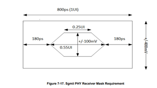

DP83867IS: 4-wire SGMII mode, TX aligned, RX unaligned, TBI through a SERDES on a microsemi board
Part Number: DP83867IS
The TX is aligned, trace cap with ILA in my fpga, proper k chars are coming in with no apparent violations - appears to be the periodic configuration from my mac layer.   The RX however, does not appear to be synchronized and from my sampling I saw multiple groups of more than 5 1's together, which tells me asynch.   In 4-wire mode the SGMII interface in the SERDES must latch onto the RX data in order to synchronize.  I wanted to rule out the PHY first however - and I wanted to ensure the configuration is occurring correctly before moving on.
Please advise:

  • Hi David,
    Are you able to provide an eye diagram for DP83867 SGMII communication? The picture below is the eye diagram mask requirement for SGMII communication:
    If possible, could you try the force mode of SGMII to see rather there is an link down issue. Force mode can be program by register 0x0014 bit [7] to disable auto negotiation and bit [11:10] for speed selection. Please make sure to configure force mode on MAC side for SGMII.
    Hillman Lin

  • I am attempting both of these now - my scope may not be sufficient - I'll have to rent one most likely.

  • I have to rent a scope, all I have is 1GHz available.

  • Hi David,
    Before going into tuning the eye diagram, Are you able to meet the specification of the eye diagram that I share earlier?
