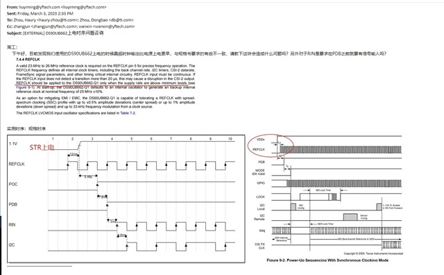

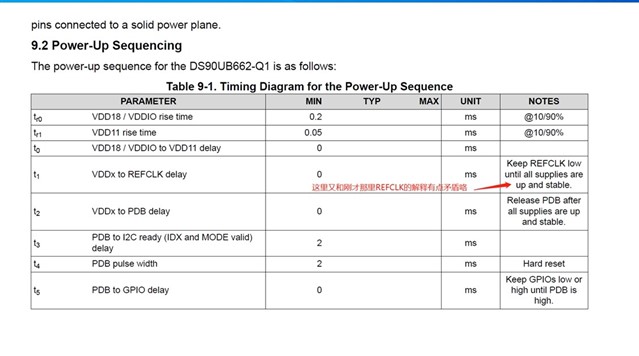

Part Number: DS90UB960-Q1
Dear expert,
1. Why REFCLK must stay in low until VDDx power up stable?
2. What are the risk if the sequence doesn't meet the requirement?

Hi Dongbao,
I don't have this information readily available, but datasheet specs should be followed to ensure the device operates normally.
