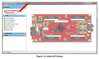

I want to know the possibilities and procedure to use the TI DS90UB949EVM via USB else share me the alternatives to control the EVK remotely.
Hi Sundar,
This EVM can be controlled using the external I2C pins with a USB2ANY, or with the on board miniUSB connected directly to your computer. The User Guide includes a quick start guide that you can refer to for detailed steps. You should be able to see the device on ALP when connected:
