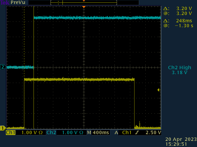

    The EEPROM configuration byte located at location 32h is set to 60h, which sets bit 14 of Downstream Port Configuration Space register 0D4h to '1', which indicates the slot is Hot Plug Capable.
    Furthermore, I have confirmed using an oscilloscope that the UP_PERSTn and DN_PERSTn signals are driven with more than 100mS delay (see following image):
    In this image, CH1 is UP_PERSTn and CH2 is DN_PERSTn. There is approximately 248 mS from de-assertion of UP_PERSTn to de-assertion of DN_PERSTn.

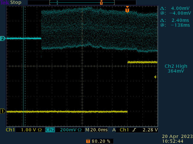

    This is further confirmed by the following image:
    Where we see that DN_PERSTn is de-asserted approximately 130 mS after the clock begins oscillating.

    If you look a the image below, you'll see an illustration of the initial activity on the downstream clock (approx. 2 sec), the period during which the downstream REFCLK is disabled (approx. 1.4 sec), and the moment at which it is re-enabled. Once re-enabled, the clock remains stable.
    • Channel 1 (YELLOW): DN_PERSTn
    • Channel 2 (CYAN): DN_REFCLKp/n
    The notation of 120 mS is the approximate delay between the downstream REFCLK being stable and the removal of the downstream PERSTn.
