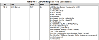

Could you tell me about the default settings for datasheet change (~RevF).
1. About the LED1.
  I think LED1pin is Active-L.
  * I understand Active-L means Low output when it moves.
 What is the default setting for LED1?
 Also, has the datasheet been changed to change the default setting?
2.About the pin16.
 Strap 0 defaults to 0 (Low), but since it is changed to internal PU, doesn't it default to 1 (High)?
