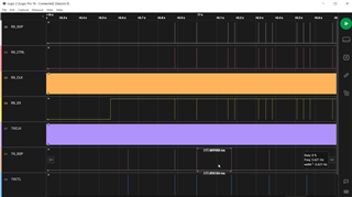

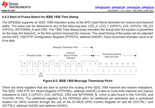

I try to use the RX_SFD pulse as defined in chapter 8.3.3 of the Datasheet.
I use default values (0x5) in register 0x3f.

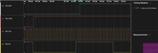

My measurements show that the RX_SFD pulse raises ca. 52 ns after SFD on RX path.

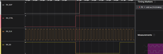

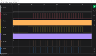

But sometimes, the pulse moves backwards to the start of the preamble, as shown here:
Can you explain why? I guess this is a malformed behaviour.
