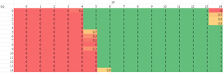

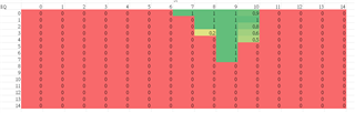

  • Hi Candy
    I'm sorry for the late reply. I have used the FPD-Link MAP tool and obtained two results. I would like to verify their accuracy.
    1.962:non-sync     953:sync
    2.962:non-sync     953:The original 953 hardware was in sync mode, and the software switched it to non-sync mode
    I don't understand why there is a difference between these two results, and whether it will affect occasional failures in the I2C. How can this be improved?

  • Hi Chung,
    I see that in both of the register dumps, 953 is in non-sync internal clock mode based on register 0x03. Is this what the 953 is strapped to, or are you overriding the mode? If you are operating in non-sync mode, the 960 back channel must be 10Mbps, not 50Mbps which is what it is showing in the first test result. That is why the margin is narrow and there is no lock. In the result with the better margin, 960 register 0x58 is at the correct back channel value (10Mbps) to be paired with 953 in non-sync mode.

  • Hi Chung,
    Thank you for the clarification, I realize I was looking at the wrong register value in the dump. Also note that 50Mbps backchannel corresponds to the term synchronous mode for both 953 and 960.
    The first result shows that the link margin is failing (see this MAP tool user guide for the passing criteria). Poor link quality can be due to the cable, connector, layout, etc.
    For the second result, the higher number of I2C errors is likely due to a high number of back channel CRC errors reported in 953 register 0x52 and 0x55-0x56. The MAP tool only reports forward channel errors, so that is why the margin may look good even if you are getting I2C errors. For back channel link quality, you can continuously monitor the CRC error count in 953 registers 0x55-0x56. Back channel CRC errors again indicate poor link quality due to the cable, connector, layout, POC filter, etc. I recommend checking these factors.
