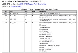

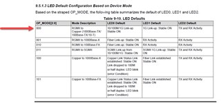

Hello, without writing to any of the configuration registers on the DP83869HM what does LED_0, LED_1, and LED_2 mean? I'm having trouble with my board and LED0 and LED1 are on continuously. LED2 does blink when I transmit data and when not transmitting the led fill occasionally blink.
I have been looking on page 66 of the 2022 Datasheet and I don't understand the table:
Is it saying that hex(6) is the setting for each LED output?
I don't understand, can someone give me a hand please?
