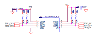

We are trying to interface an LED display board driven by TCA9555 which is I2C based to TM4c1294 Launchpad ( EK-TM4C1294XL).  We are able to interface the TCA9555 directly and able to drive LEDs which are working.  However it works for only for 15 minutes and after that the TCA9555 is out of control and does not respond at all.   Since we are using a cable of 20 cm  we tried to put a repeater in between based on TCA9509.  However once the A side of TCA9509 is connected to controller, there is no pulses on clock (SCL) and data(SDA) and hence no communication,  We removed the inputs side pull up of TCA9509 and checked

In TC9509 En pin is actually pulle up.'

    I just noticed in the schematic image you provided that you have 10k pull-up resistors on the A-side of the 9509. These need to be removed since the 9509 integrates a 1mA current source on the A-side. There is no need to include pull-up resistors on the A-side. These pull-ups might be interfering with the VILC spec, which is the low-level voltage contention spec, and may not be able to pass signals from the A-side to the B-side.
    Remove the pull-up resistors on the A-side, and see if communication resumes with the buffer in place.

    It looks like the TCA9509 in your circuit has 10kohm pull-up resistors on the A-side of the device. I am sure that there are also other devices connected to the A-side of the I2C bus as well.
    TCA9509 has a spec called low-level voltage contention or VILC for the A-side. VILC must be met at all times for the A-side in order for a LOW to be passed from A-side to B-side. The 10kohm pull-up resistors R56 and R51 need to be removed since TCA9509 implements a 1mA current source connected up to VCCA. The addition of pull-up resistors and extra sources of current may make it difficult for every device on the A-side to be able to pull the I2C bus below a VILC. If the controlling device cannot pull its output low voltage VOL below a VILC, then you can expect TCA9509 to function incorrectly.
    I would remove those resistors R56 and R51, and any other sources of pull-up current on the A-side that could affect the VOL levels and re-check to see if TCA9509 can pass signals.

  • I am still on travel this week.  Actually we have tried removing the A side pull up and then TCA9555 stopped responding!   After I come back I will try putting the series resistor in I2c lines.

    Are there any other devices connected to the A-side of the bus?
    This is telling me that the TCA9555 is on the A-side. Is it possible to flip the buffer? Connect the TCA9509 B-side with pull-up resistors to the TCA9555 while removing pull-up resistors from the A-side?
