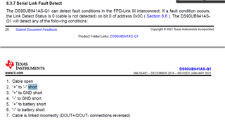

Is there need extra hardware design to achieve link fault diagnostics function as below:

Hello Yuan,
No. No extra hardware is required for serial link fault detect. Note that it, however, does not tell you which condition has occurred. Extra hardware would be required to achieve this identification.
Kate

Hi Kate,
got that, but it's not for FPD3 device, my question is for 941, for "Extra hardware would be required to achieve this identification.", do we have guidance?
thank you
Hi Yuan,
I have provided clarification in the email chain.
