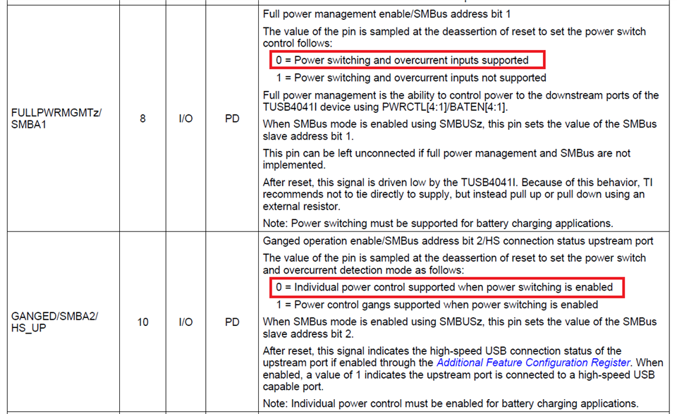

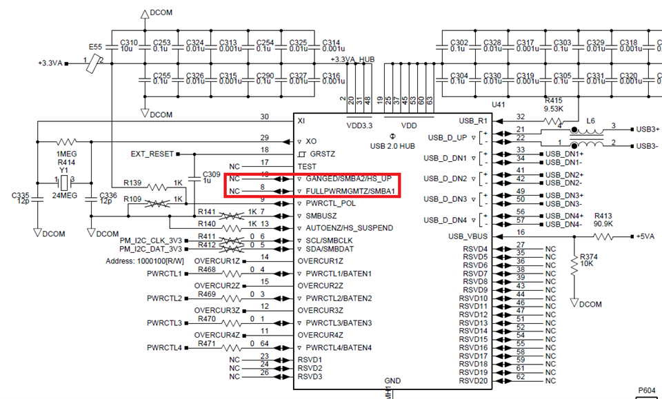

My customer is asking whether pin 8 & pin 10 can be left floating (NC) ? In their circuit application with these two pins NC, they see no issue to implement over current and PWRCTRL for each downlink port.

You can leave both pins as NC since they have internal pulldown.
