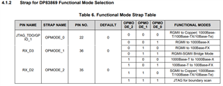

    I have set the OPMODE pins [0] = OPEN, [1] = OPEN, [2] = 2.5k Pull-up
    I have also set the LED pins [0] = 0, [1] = 1, [2] = 1
     I am curious what changes between normal and PWDN mode which might prevent me from accessing the registers. Can you think of anything that may cause this?

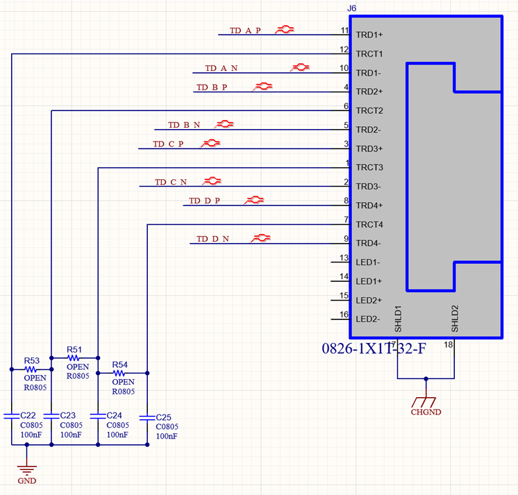

  • Sure. Here are the relevant pieces from the custom board. The jumper settings are the same, as noted by register 006E of each DP83869.
    document1.pdf
  • Hi Ryan,
    It looks like you are not establishing link on either side, please try the following:
    1. Restart auto-negotiation when the boards are connected together and reread the registers afterwards
    2. If you have multiple custom boards, try connecting them together to see what happens then.
    It looks like you did not change anything on the magnetics side or the straps, is this correct? Did you change the stack up at all?

  • I have tried to probe my TD_X_X signals but I think the capacitance and/or impedance of my scope probes are causing some issues with my signals. I now believe that the issue is on the ethernet side. I have a new version of my board which I have ordered. It should be here next week. I included all of the changes which I had to patch in to the first board and I made some pretty big signal integrity improvements to the differential pairs and surrounding planes/layers. It will be a week or so until I have the new board in hand for testing. I will update at that point. I am reasonably confident that this should solve it since I was able to replicate the issue using the two EVM boards.

    https://www.digikey.com/en/products/detail/bel-fuse-inc/0826-1X1T-32-F/2257873

    Looking at the specifications, this part seems to meet all of our magnetics requirements.

    If you are seeing that 2 TI EVMs are unable to link upon connection, it is possible that the OPMODEs for both PHYs are not configured correctly.
    There are 3 jumpers on the EVM labelled OP_MD[1]-[2]. You can set OPMODE_x to 0 by leaving the jumper unpopulated or to 1 by connecting the two pins. You want the two PHYs that are linked to have the save OPMODE and set to the correct medium and MAC interface.
