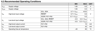

      this statement on data sheet, not sure what meaning of " should not exceed the recommended level" .
    The statement "recommended level" is usually found in the recommended operating conditions of the datasheet which I have listed below.
    Generally speaking, if the recommend operating conditions are followed, you can expect the device to behave according to the electrical specifications in the datasheet. If you traverse outside the recommended operating conditions, the device may not be properly or show certain electrical characteristics as listed in the datasheet. However, the absolute maximum conditions always need to be respected at all times in order to ensure permanent damage is not done to the device.
