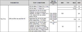

What can you tell me about tRHS and tFHS as described in the data sheet?
Will this standard RISE and FALL for differential waveforms?
Or are they rise and fall for single-ended P and N observations?
If you have a FIGURE, please provide it.
I checked by myself and found the following waveform on the Teledyne website.
Are tRHS and tFHS correct for this waveform observation method?
(I call this waveform single-ended observation).

    The parameters shared from the datasheet are from the MIPI D-Phy specification v1.2. You can refer to the specification on the MIPI website: MIPI D-PHY
    Additionally, the Teledyne waveform shared appears to be for MIPI M-Phy instead of D-PHY.

    The rise and fall specification will be the same for single ended and differential waveforms.
    We generally refer to MIPI specification and can not share from the document as it is restricted. For additional details, I recommend gaining access to the document through MIPI.

    As one example, a diagram is attached.
    It is an example, so it is not MIPI.
    From this diagram it is understood that the rise and fall in single-ended and differential waveforms will be the same specification.

    I suggest referring to the Tektronix or Keysight websites for information on acquiring D-PHY waveforms. These websites will provide guidance on performing waveform measurements regarding the specification.
    In our own testing, we used the Keysight 1134B probes with differential probe heads. The waveform type recommended will be determined by the probes you are using.
