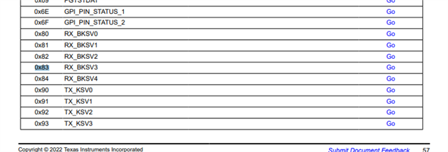

    But I didn't find 0x88 in the datasheet as below. Could you tell me what register should I configure, if I want to configure a 400kHz? 0x83 and 0x84 or 0x88 and 0x89? What value should I set?
  • Hi Hale,
    Sorry, typo before. It is 0x26 and 0x27 for 948.
    Convert 400kHz to high/low time: 1250ns
    Divide high/low time by 50ns: 25
    Convert 25dec to hex: 0x19
    Write 0x19 to 0x26/0x27.
