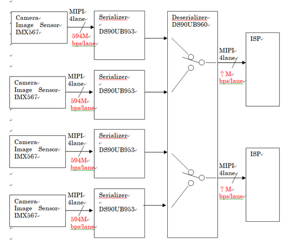

Q1) In case of below the block diagram, can we set 594Mbps/lane of MIPI output at the DS90UB960?
Q2) If we can't set that one of (1), how many data rate "one lane at one CH"   of the DS90UB960?
  • Hi Sugi,
    The 960 CSI-2 transmitter can be configured to 400 Mbps, 800 Mbps, 1.2 Gbps, or 1.6 Gbps per data lane per port. The sum of the input bandwidths to be forwarded must be less than the output bandwidth, so you would need to select a speed that will fulfill this requirement. Can you provide the following information about your system so I can accurately determine what lane speed you will need?

                   I want to use DS90UB960-Q1 as only multiplexer. And I chose 1 image sensor with 1 output on DS90UB960-Q1.
                   And I expect the MIPI signals pass through as same data rate on DS90UB960-Q1.
                  Therefore, I expect 594Mbps/lane of DS90UB960-Q1's output.

  • Hi Shuichi,
      Q1) we showed the block diagram, can we set 594Mbps/lane of MIPI output at the DS90UB960?
    You can only set the CSI-2 transmitter speed at certain rates, so 594Mbps is not possible (see section 7.4.19 in the 960 datasheet).
      Q2) If we can't set that one of (Q1), how many data rate "one lane at one CH" of the DS90UB960?
    Based on the parameters for the 4 image sensors, your total input bandwidth sum including CSI-2 overhead is about 3.67Gbps. The equations to calculate this are in section 7.4.20 in the datasheet.
    If you are using 2 CSI-2 ports with 4 lanes per port, you will need a CSI-2 lane speed of at least 800Mbps per lane to meet the bandwidth requirement (assuming all ports are being forwarded). You just need to ensure that the input bandwidth sum is less than the output bandwidth.
      Q3) Can I use the DS90UB960-Q1 as only multiplexer?
    If I am understanding your diagram correctly, you want to select either RX port 0 or 1 to be outputted on CSI port 0, and select either RX port 2 or 3 to be outputted on CSI port 1? This should be possible by configuring register 0x20 FWD_CTL1. In this register, you can disable forwarding of any of the RX ports, and you can also map the different RX ports to either CSI port 0 or CSI port 1.
    By default, the forwarding method is best effort round robin in which there is no special ordering of the CSI-2 packets (see section 7.4.25 for more information on forwarding methods).

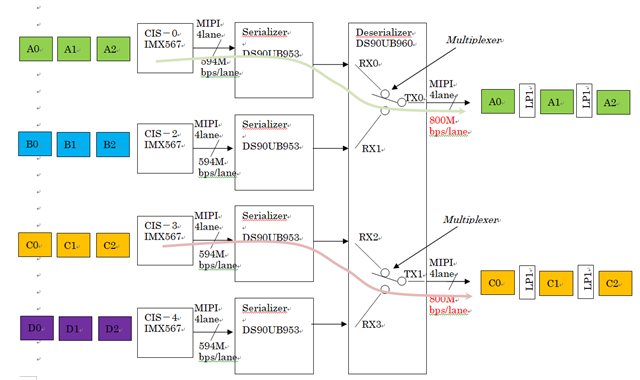

    I made more figure. Please see below figure.
    In this case, I want to select either RX port 0 or 1 to be outputted on TX port 0, and select either RX port 2 or 3 to be outputted on TX port 1.

    Q4) Our questions are about the relationship between the CIS signal of the serializer input and the deserializer output.
     Q4-1)
    This is explained in the diagram above. Does a relationship correct between "A0, A1, A2" order on the CIS side and "A0, A1, A2" order of the DS90UB960 TX output?
     Q4-2)
    And, does It also correct or incorrect about "C0, C1, C2"?

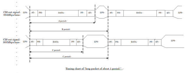

    Q5)It's about the relationship between "Period of long packet" on CIS signal of the serializer input   and   "Period of long packet" on the deserializer TX output.
     Q5-1) Please see the below figure.
    Can we get below timing chart, if we apply above block diagram and setting registers?
     Q5-2) Is below explanation correct or incorrect?
    In this case, my understanding is below. ”C period" is shorter than "A period". But "B period" and "A period" are same time. Because we think that the LPS period absorbs the difference between the two data rate. In fact, we need this timing.

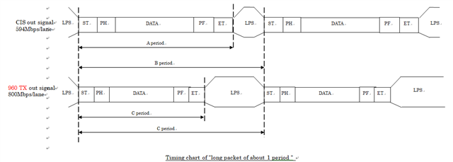

  • Hi Cindy,
     I made a mistake figure last post. I'm sorry.
     Please change a  figure. I mistook a name of signal on time chart. It's output signal of DS90UB960 TX.
    Shuichi Sugi
  • Hi Shuichi,
    Yes, packets received on a single input port will be forwarded in the received order. So if you only have one RX port enabled for forwarding on the CSI-2 output, then the packets will be forwarded in the order in which they are received. You can configure the RX port mapping and enabling/disabling in register 0x20.
    Yes, same as above answer.
    Your explanation is correct. The deserializer will wait for one full video line to become available before sending the data out at a fixed rate. Since the CSI-2 TX output speed is faster, it will fill the remaining time in the LPS state to maintain the same frame rate. You can refer to this training video for more information: https://www.ti.com/video/6247583604001?keyMatch=
