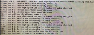

We found that only a few USB3.0 device can be recognized and all the USB2 device can't be enumerated.
Is there any setting we can check?

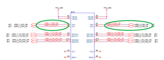

This is the same project I ask in the internal forum before.
I can send you the schematic again.
For type-C, you can not connect two USB2 ports on one C- connector, normally people shorts DP1/DP2, DM1/DM2 on connector.
