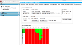

Additionally, can you run the MAP tool on a good camera and a bad camera?

Would you be able to try MAP tool on the imagers once more? If not, can the registers for BCC_CRC_ERROR, LOCK_STS_CHG, BCC_SEQ_ERROR, PARITY_ERROR, and FPD3_ENCODING_ERROR be monitored on the DS90UB954? These are reported in registers 0x4D and 0x4E.
