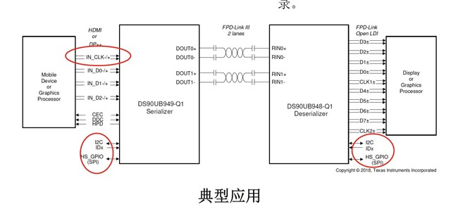

Is it possible to transmit I2C and GPIO between the 947 and 948 without input from the IN_CLK+/- on the 947 side?

Yes, you don't need any input for the 949-948 to be able to transmit GPIO and I2C.
