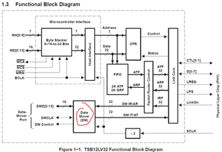

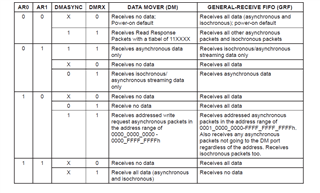

    Isochronous receive packets will be routed to the DM port or the GRF via the receiver routing control logic as shown below, where are you routing the isochronous packet?
    Are you also doing isochronous receive with or without header or trailer?
    David

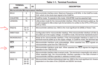

    I am referring to MA[0:6[] and /MCS as shown below,
    David
  • Hi David,
    The datasheet doesn’t indicate an issue with keeping the address bits set after the initial cycle when MCS sets low. I’m going to figure it’s okay. TI designed this part so if you have notes that indicate it would be a problem, I’m guessing you could find them.
    Pease advise
    Josel
