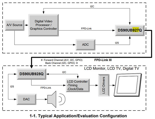

So customers want to know which registers need to be configured for communication between DS90UB928Q and DS90UB927Q?

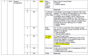

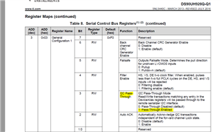

    If you want to enable remote I2C communication between 927 and 928 you need to enable I2C Pass through.
    From 928 side the default value of register 0x03 = 0xF0 you need to change this to 0xF8 to enable pass through.
    From 927 side the default value of register 0x3 = 0xD2 you need to change this to 0xDA to enable pass through.

    I don't understand your question? Register tables are provided in the datasheet of each device. For 928 please refer to (Table 8. Serial Control Bus Registers)
    As far as configuration, you don't need to change anything, those parts are plug and play unless you need to enable additional features, etc. you can modify the restier values to enable certain features also can refer to Mode_sel section (8.4.4 Mode Select (MODE_SEL)) for changing the straps of the device.
