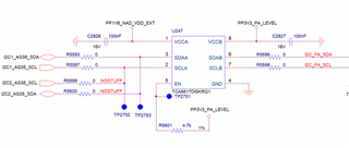

For TCA9517DGKRQ1,if partical power down of VCCB, what is the state of pin SDAB/SCLB ? and if VCCB power on again will the device work normally?

If VCCA keep power on and VCCB power off , the pin"SDAB/SCLB" goes to hign impedance state?

Clemens' is correct here. For the output drivers to be turned on, it must meet the requirement such that VCCA is above 0.8V and VCCB is above 2.5V. Since only one of these conditions are met (VCCA >0.8V), this means the output drivers will be turned off and signals will not be able to propagate through the I/Os.
Also note that the I/Os will also be over-voltage tolerant (up to 5.25V) when VCCA and/ or VCCB is powered off.
