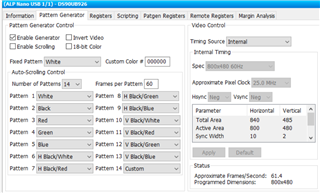

Dear Sir:
I set below registers to output default RGB888 60Hz video
write 0x04 to Reg65 -> The pattern generator creates its own video timing as configured in the Pattern Generator
wirte 0x11 to Reg64 -> Enable Pattern Generator
Use oscilloscope to measure PCLK/HS/VS/DE waveform. Is it right?
Do we must write 0x03 to Reg65? It has no effect. thanks!!

Hi General Chiang,
Based on the ALP image you provided all the configuration have been set according to the table 3-8 in the application note. ALP does all the configuration for you, so this should be correct. Are you only probing the HS/VS/DE/PCLK pins? or are you connecting to a display?
