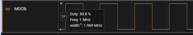

Hi, I am currently trying to use a DP83822HF as the PHY device in an ethernet set up with the TMS570LC4357 in MII mode in 100Base-TX Full Duplex communication. Currently I am seeing an issue where the timings of periods outlined in the DP83822HF datasheet do not match what I am seeing.
As you can see in the pictures below that I captured using a logic analyzer I am running MDClk at 1MHz (standard clock speed according to TMS570LC43567 datasheet), but for some reason I am getting very strange periods for the Fast Link Pulse from the DP83822HF
I am seeing 16ns for Clock/Data Pulse Width as opposed to 114ns, ~22us for Clock Pulse to Data Pulse Period as opposed to ~62us, ~45us for Clock Pulse to Clock Pulse Period as opposed to ~125
One last note:
I am also only seeing this behavior after power cycling the TMS570. After a clean flash to the TMS570 via JLink Flash or Code Composer Studio debugging session I see standard periods as outlined below in the DP83822HF datasheet, but once I power cycle the TMS570 I start seeing these odd periods.
Any insight on what the issue may be is greatly appreciated
