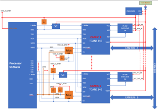

  • Hi Eric,
    Thanks a lot for your deep explanation.
    In sleep mode our processor will be in low power mode, in this mode standby supply is available in processor communication ports to detect any interrupt/state change on the communication ports.
    From your message we under stood we need a pull up resistor in RXD Pin because TCAN1146 VCC and VIO are not available in sleep mode.
    Here I have shared our TCAN1146 architecture to your mail ID (e-schott@ti.com) , We are using Qty 6 TCAN1146 IC's in our design.  In architecture diagram only shown 2 TCAN1146.
    We are going to connect QTY 6 TCAN1146 IC's with a single SPI bus to processor with individual chip selects. is this a problem ?
    We need few more details form you regardingTCAN1146 usage, please provide your inputs on following points
    1. We are planning to use following mux SN74LVC1G3157-Q1, for SDO/nINT pin. Can you confirm what is the state of not connected MUX pin whether it is open drain ?
    2. Mux output  of all TCNA1146 nINT pin's, We are plaining to tie all together and connecting to single processor pin with a pull up resistor to detect nINT status change, Please confirm whether we connect like this ?
    3. Please suggest if you have any other mux options which you fell better fit for our application compared to above .
    Thanks & Regards,
    Murali Penta
    mpenta@fiskerinc.com.

  •  TI Team,
    Since Manoj not available currently, I am writing further queries on TCAN1146 behalf of him.
    As per discussion with Eric Schott in TI forum, we will use TCAN1146 RXD pin as wake events indicator to the MCU.
    We also want to detect other interrupts which are indicated through SDO/nINT pin in normal mode (except sleep to wake indication), because we are using Qty 6 TCAN1146 IC’s, every time polling with SPI bus is difficult in normal mode.
    I have attached our TCAN1146 block diagram FYR. In block diagram we have shown only 2 TCAN1146 IC’s . In actual scenario qty 6 TCAN1146 will be there.
    @e-schott@ti.com the following queries, with respect to nINT pin connection with processor.
     1. We are planning to use following mux SN74LVC1G3157-Q1, control via chip select pin of TCAN1146. Can you confirm what is the state of not selected MUX output ( when chip select is LOW & SDO connected to processor) whether it is open drain ?
    Also please suggest if you have any other mux options/part numbers which you feel better fit for our application compared to above.
    2. We are connecting nINT signals of all Mux outputs (Qty 6 TCAN1146) together and connecting to a single processor pin with a pull resistor ( Please see in block diagram for clear understanding).
    So that any TCAN1146 IC nINT pin interrupt can detected in normal mode, after that we will start polling through SPI bus to k now the which TCAN1146 generated.
    Do we need pull up resistor at Mux input also ( at TCAN1146 SDO/nINT pin) ?
    Please confirm if you see any issues while tying all TCAN1146 nINT pins together( MUX outputs) and connecting to single processor pin?.
    3. Things mentioned in the datasheet below, will it make any issue for our design , because we are using MUX on SDO/nINT pins of all TCAN1146 IC’s it will isolate the SDO line and nINT line.
  • Hi Murali,
    Sorry for the long delay on this one. In summary of the below responses, I don't see any issue with the proposed solution in the diagram here.
    The nINT pin configuration (when nCS is not asserted) is an open drain output with internal pull-up to Vio. This is fine to be muxed with multiple other nINT signals.
    Yes, I would recommend including an external pull-up to Vio on the MCU-side of the nINT MUX's.
    I see no issue with this solution.
    I'm not sure what is meant by this. The MUX solution for the nINT and SDO signals is included as an example in the datasheet in figure 10-6. I don't see any issue combining the nINT signals on the MCU-side of the MUX's when multiple TCAN1146s are used in the same application.
