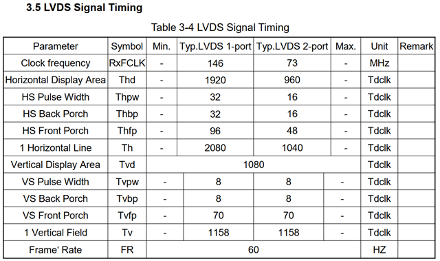

One customer has below problem used DS90UB948+DS90UB949.
Ds90ub949-q1 is used with DS90UB948-Q1,hdmi output to ds90ub949, 948 output to screen, the screen is not displayed but the backlight of the screen is bright, and i2c can communicate with Ds90ub949-q1 and S90UB948-Q1.
T he pattern test is performed, the screen is also not displayed.
Perform the configuration according to 4.4 Cases in the SNLA132G document. Use the Without FPD-link III scheme and configure 948 to enter Pattern test. The screen displays no information.
code show as below:

How should I judge the problem?
How to make patgen work only on deserializers before using patgen via FPD-Link?
The Display parameter is as following:
Please give me a reply. Thank you very much

  • Hi Kailyn,
    What you have programmed is 1920x1080p for the 948 patgen.
    Total timings which you have programmed:
    Htotal: 2200
    Vtotal: 1125
    HActive: 1920
    VActive: 1080
    HBP: 148
    VBP: 24
    HSW: 44
    VSW: 5
    Positive polarity.
    You have also enabled external clock mode.
    This timing does not match the timing table you have posted. Can you confirm the timing I have listed is correct and compatible with the display?
