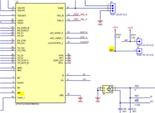

We have purchased two Evaluation boards, to experiment with implementations on the DP83TG720 PHY. They are connected via an automotive connector and power is supplied by the microUSB. One is a master and the other is a slave.

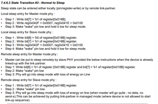

As mentioned in the manual of the  DP83TG720 PHY, i had tried both the local and remote sleep
But the eval boards, did not go to sleep. On further reading, i saw that the implementation for sleep mode required is that an external pull down resistor be placed at the INH pin, for the sleep mode
But on the eval board schematics, for the same phy implementation, below was observed
The INH has a pull-up resistor.
Our query is
1) Does this mean that as the INH pin is not connected to a pull-down resistor it will not go to sleep?
2) Is there sleep/wake-up functionality, present for this model evaluation board?
Thanks in advance

    Unfortunately, DP83TG720EVM-MC is not the best option to evaluate the PHY's sleep mode due to the fact that the PHY's power supplies need to also be cut to put the PHY into sleep mode.
    DP83TG720 has a custom sleep solution (not TC-10 like other PHYs in our portfolio) and has not been tested with our link partners other than DP83TG720.

    For the DP83TG720EVM-MC, there is a 3V3 and 1V supply jumper on the board. If we remove the jumper, can't we cut off the supply after setting the 7th bit to 1 in register 0x018B as described in the manual, to transition from normal to sleep mode? In this case, we would, remove the jumper on the wake pin as well and connect the same jumper to ground, to make the wake pin 'low'.
    The above, is if the INH pin does not affect control on the power supply in the board. Hence, the query

  • Hi Aarathi,
    INH pin is only an output. However, I do caution, that the EVM is not the best platform to evaluate DP83TG720's sleep mode feature due to the fact that supplies are not cut off immediately upon entering sleep mode.

    Yes, just wanted to confirm whether the schematics are correct. Thanks. Yes, we have come to see that it may not be the best solution to testing.
    If we manually pull out the jumpers connected to 3v3 and 1v power supply on the eval board, after setting the registers for the sleep operation, would that not be a feasible option?
    Thanks and Regards
    Aarathi Thomas
  • Hi Aarathi,
    It would not be fully feasible as the timing sequence would not be fully realized.
