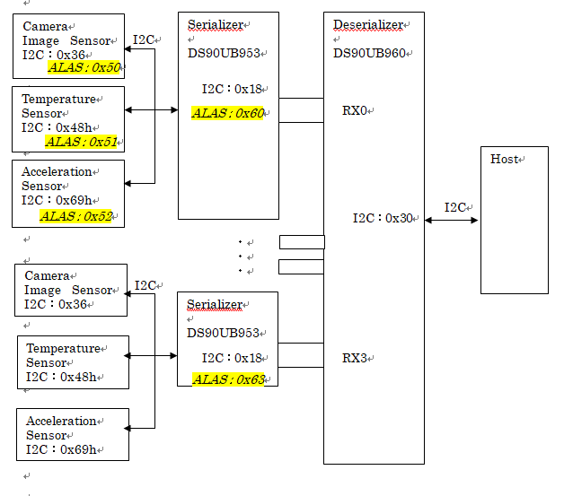

Please see our block diagram of system below, and the system condition of settings  below.
Condition:
- For example, I'll use to through RX0.
- I set a registers for DS90UB960.
  address, data
  0x0C,0x0F
  0x4C, 0x00
  0x58,0x5E
  0x5D,0x48 :It's target the slave address 0x48 of device.
  0x5B,0x00
  0x5C,0x60 : ALIAS of target device's "slave address" is 60h.
I want to access to I2C devices attached the DS90UB953 from the host.
Q1)In this case, is it okay if the register value of DS90UB953 is default?
Q2) If Q1 is incorrect, please tell me the DS90UB953 of register settings for us.

  • Hi Lucas,
     Thank you for answering for us.
     I understood about Q2-Q3. but I don't understand some things.
     So I added some information to the block diagram. Then I ask you some question on this condition.
    Q7)How to communicate to registers of the 935(I2C:0x18) on RX0?
          And could you write registers setting this case for me.
    Q8) How to communicate to registers of the Image Sensor(I2C:0x36) on RX0?
            And could you write registers setting this case as well.

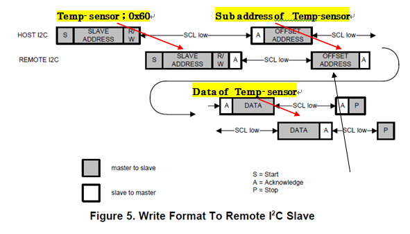

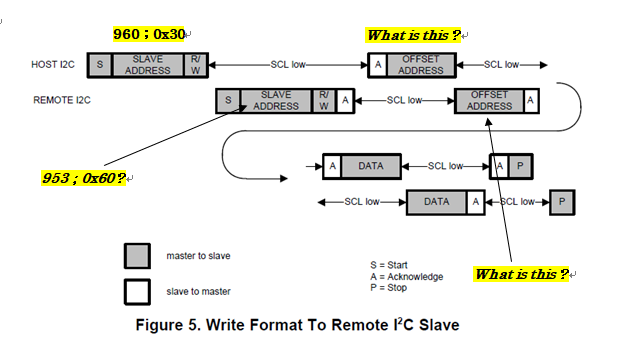

    And I have more question. It's about protocol of communication to the I2C end device.
    Please see the sequence of I2C protocol to communication for end devises below(Refer: SNLA131A–July 2011–Revised April 2013).
    Q9) Please tell me what should we set what slave address on yellow letters mean?
         EX: In case of communication to seriarizer(originary  I2C:0x18) from the host.
           Is it OK if we set 0x30 at first Slave address?.
           Is it OK if we set 0x60 at second Slave address?.
    Q10) Please tell me more detail about the sequence of I2C protocol to communication for end devises.

  • Hi Shuichi,
    I noticed that your acceleration sensor I2C address is 0x69. Typically 8-bit I2C addresses are even numbers because the 0th bit is used to determine if you are performing a read or write operation. Is the address 0x68/0x69 for an I2C write/read?
    Additionally, I noticed that some aliases you chose are odd numbers such as 0x51 and 0x63. Aliases should be even numbers because the 0th bit will be used to differentiate read and write operations, so you will need to change these.
    You can use the following register configuration to set all of your device aliases.
    •  960 configuration:
      • 0x0C, 0x09 (enable RX0 and RX3)
      • 0x4C, 0x01 (select RX0 for RX port-specific reads/writes)
      • 0x58, 0x5E (enable I2C_PASS_THROUGH)
      • 0x5C, 0x60 (set SER alias 0x60)
      • 0x5D, 0x36 (set slave ID0 as image sensor 0x36)
      • 0x5E, 0x48 (set slave ID1 as temperature sensor 0x48)
      • 0x5F, 0x68 (set slave ID2 as acceleration sensor 0x68)
      • 0x65, 0x50 (set image sensor alias 0x50)
      • 0x66, 0x__ (set temperature sensor alias, 0x51 isn't valid)
      • 0x67, 0x52 (set acceleration sensor alias 0x52)
      • 0x4C, 0x38 (select RX3 for port-specific reads/writes)
      • 0x5C, 0x__ (set SER alias, 0x63 isn't valid)
      • 0x32, 0x01 (select TX0 for TX port-specific reads/writes)
      • 0x33, 0x01 (enable CSI-2 output, change bits 6:1 as necessary)
      • 0x20, 0x90 (enable forwarding on RX3 and RX0)
    • 953 alias 0x60 configuration:
      • 0x39, 0x36 (set target ID0 as image sensor 0x36)
      • 0x3A, 0x48 (set target ID1 as temperature sensor 0x48)
      • 0x3B, 0x68 (set target ID2 as acceleration sensor 0x68)
      • 0x41, 0x50 (set image sensor alias 0x50)
      • 0x42, 0x__ (set temperature sensor alias, 0x51 isn't valid)
      • 0x43, 0x52 (set acceleration sensor alias 0x52)
    • 953 alias 0x63 (this will need to be changed) configuration:
    To communicate with any SERs or sensors, first select the correct RX port using register 0x4C on the deserializer. Then you can access the SER or sensor using its alias, or physical address if it doesn't have an alias. I suggest reading sections 7.5.3-7.5.5 of the 960 datasheet to better understand remote I2C transactions to slave devices.
    Figure 5 shows data in parallel as it is sent/received by the host and the slave device. The first two boxes show the slave address as it is sent by the host and then received by the slave. Therefore both of these boxes will have the same slave address, which would be 0x60 in your example.
    The offset address boxes refer to the register address.
    The SNLA131A app note is a good resource to understand how I2C communication works over FPD-Link III. Please let me know if you have any additional questions.

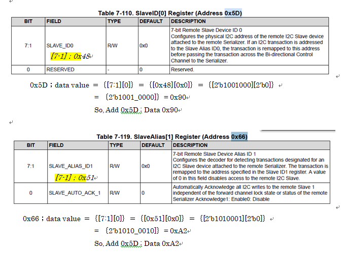

  • Hi Lucas,
     In fact, we could communicated to remote I2C devise.
    I show you registers setting at success.
    <960 configuration: I tested connect only RX3
      0x0C,0x08 (enable RX3)
      0x4C, 0x08 (select RX3 for port-specific writes)
      0x58,0x5E (enable I2C_PASS_THROUGH)
      0x5C,0x60<<1=0xC0(set SER alias)
      0x5D,0x48<<1=0x90(set slave ID1 as temperature sensor 0x48)
      0x65,0x50<<1=0xA0(set temperature sensor alias)
      0x4C, 0x30 (select RX3 for reading remote I2C )
    <953 configuration:
      We do not set anything
    And I ask your questions.
      --- skip --
    Shuichi Sugi answered:
    I have shown the I2C slave address as-is in the diagram above.
     For example :0x51
    However, the setting to the 960 register is the upper 7 bits. Therefore, it’s necessary to one shift the implemented slave address. As a result, the following register values are always even.
     For example :0xA2
     Our problem has been solved.
     Thank you for your help.
