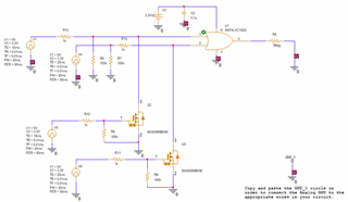

I'm trying to simulate using Pspice for TI, but I'm having trouble running it. The schematic is below.
I will send you the error contents in a text file, so could you give me some advice?

ERROR(ORPSIM-16583): Detected an imported model containing transistors or diodes. For such models, PSpice for TI supports a minimum of one and maximum of three traces. Reduce the number of traces and simulate again.

Conor
  • Hi Conor,
    Please place 3 markers into your schematic as you can only save 3 signals due to non-TI models used in this design.

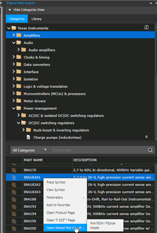

  • You can play with any built-in TI test projects. They should work without special requirements:

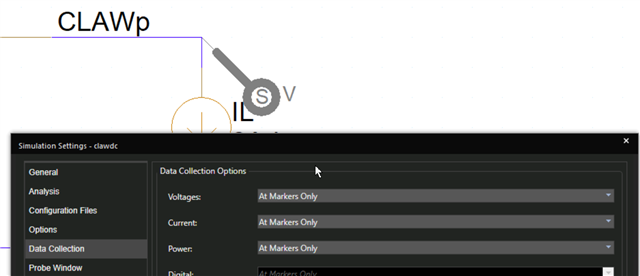

    For the issue you are seeing, please check whether the sim profile is set up to save the markers rather than save all because your circuit and model configuration does not support saving all signals. This is the correct setting:
    -JC
  • Hi, JC
    When I checked Settings >Data Collection> Data Collection Options, it was not set to "At Markers Only". So I tried running it after setting "At Markers Only", but the same error occurred.
    After trying various things, after placing a marker, the simulation was successful when executing Run.
    I remember that it was not such a procedure when it was executed for the first time, but do you know the cause?
    Conor
  • Hi Conor,
    Yes this option works when markers are placed in the schematic, otherwise PSpice does not know what signals to save.
    It is required when certain components are present in the schematic. Previously you were probably running a design with built-in components only.
