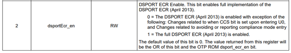

Hi Experts,
There is a bit as below.
Device Configuration Register 2
What does this bit mean? Can customer use this bit as default?
Customer is going to do the compliance test as this bit is default which is 0. Is it OK?

Uchikoshi:
when this bit is 0, it will not report port status changes when device connected or disconnected.
if customer need to get USB logo , they need to change this bit to 1.
