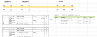

For integrating with Orin AGX SOM via the RGMII interface, We checked the I/O levels for HIGH and LOW between the devices. The margin for one of the cases(i.e PHY Output LOW to Orin AGX Input LOW) appears to be 0.
We do not have options to change the I/O voltages in Orin AGX SOM.
Is it safe to interface the aforementioned devices despite low margin?  Can TI provide relevant suggestions for this?
