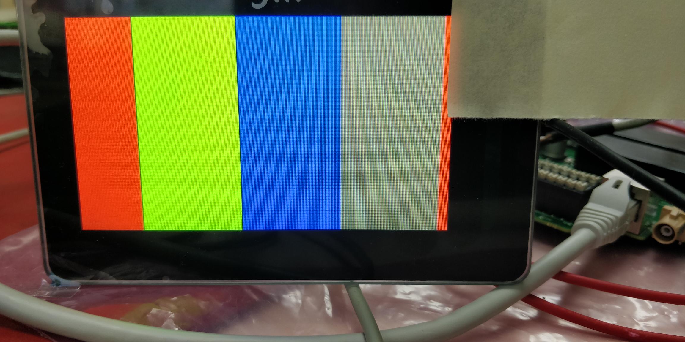

We are working whit a custom board based on the imx8mp that has the SN65DSI83 used to connect a LVDS display to the SOC. The OS has been generated using Yocto hardknott and the NXP BSP. We are using the kernel version 5.10.72.

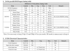

The connected display has 480x272 pixels resolution and the display parameters showed in the datasheet are:
The LVDS clock frequency we measure on the side of the display is 28960000 Hz.
The resulting image is:
In the point 1 the edges should be white but it is painted in blue color.
In the point 2 there this a color change horizontally which is not in he original image.
Is there an incorrect value stored in any of the registers?? What parameters can affect what is shown in points one and two of the image above?

    Looking at the panel spec, is my understanding correct that the DCLK is the DSI83 LVDS clock frequency that needs to be outputted to the panel? If this is the case, then the DLCK frequency is outside the DSI83 LVDS clock supported range. The minimum LVDS clock frequency DSI83 can support is 25MHz.
    David
  • Dear David, thanks for your prompt response.
    Our screen has an LVDS to 24bRGB adapter embedded. We are interfacing the SN65 to the LVDS signals that must be between 20MHz and 71MHz, so this should not be an issue for the SN65. Or that's what we think...
    I have included the 24-bit RGB information because there we can find the information for the HSYNC and VSYNC configuration.
    Thanks and kind regards.

    The PLL_EN bit and SOFT_RESET bit are not set as they need to be set per the recommended sequence defined in the datasheet
    When I activate the test pattern using the register 0x3C, the display shows the following image:
    I don't kwon where the problem can be, if the DSI is not correct or the DSI83 register configuration is not correct.
    Do you think incorrect values are stored in any of the registers for this specific display? What parameters can affect what is shown in points one and two of the image above?

  • Hi Gustavo,
    What is the DSI clock frequency on the DSI83 input?
    Thanks, Allison
  • Hi Allison,
    The DSI clock frequency is 86.88 MHz
  • Hi Gustavo,
    The register configuration seems to be correct. Are you following the initialization sequence outlined in table 7-2 on the datasheet?
    Thanks, Allison
