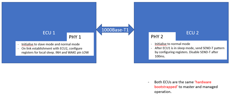

    As shown in the diagram below. ECU 1 and ECU 2 have the same hardware design.
    As they are hardware bootstrapped, slave mode configuration via register access is in needed.
    As well as the transition from standby to normal mode via register access due to managed mode bootstrap.
    Also, we are focussed on the INH pin, transitioning to low and high. The INH pin is not connected to a PMIC currently. Once we see that the pin transitions we manually trigger(on/off) the power supply for the VDD1P0. VDDIO, VDDA
    For ECU 1, the following steps are performed:
    • Initialise to slave mode: 0x1834 = 0 x8001
    • Initialise to normal mode: 0x018C= 0x0001
    Link is established with ECU2.
    Then local sleep for ECU1
    On wake pin going low, we can see that the INH pin goes low. We then turn the pin for power supply(similar to the PMIC) off.
    For ECU2, the following steps are performed:
    • Initialise to normal mode : 0x018C = 0x0001
    Link is established with ECU1
    After local sleep in ECU1, ECU2 remote wake up as remote link-partner are performed
    • Step 1 is done. On sending the SEND-T pattern we should observe the INH go high. Unfortunately I am not able to see that
    Is there any step missing? Or are there any possible suggestions as to why ECU1 may not be waking up.
    I can locally wake up ECU1, by setting the wake pin high.
    Thanks and Regards
    Aarathi

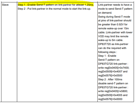

  • Hi Aarathi,
    Can you probe the line after you enable Send-T on the link partner? I would like to see if there is energy on the line after performing the writes. Note that 0x405, 0x509, 0x576 are extended registers so you must use the procedure listed in section 7.4.11 of the datasheet.
    David

  • Hi Aarathi,
    The master mode link-partner will start Send-S signals to start the link-up. We can restart the link up process by writing 0x1F = 0x4000 on the master mode PHY. Please try this write and let me know if the slave side PHY wakes up.
    I am not sure what you mean by "the frequency range for transmission and reception", could you clarify this?
    David
