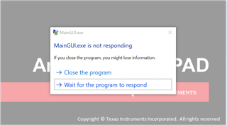

I would like to use the Analog Launchpad tool to configure the DS90UB941AS device.
But for some reason the tools does not work:

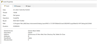

I used Procmon to understand what happens. It's looks like a file is missing:
Can one of you instruct me how to solve this?
  • Hi Jan,

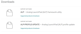

    Thank you for reaching out. Did you run the ALP Profile Update file as well? Have you tried uninstalling and reinstalling ALP?
    Kate
  • Yes, I downloaded and installed the latest version from the website:
    Good to know I had a older version on my PC. That version, I don't know the version, works without issues.
    But after the update it does not work and I don't have a copy of the older installer. Is it possible to download it from the TI website?
  • Hi Jan,
    As clarification, is it the newest ALP install that caused it to stop working or is it the ALP-PROFILE-UPDATE install that caused it to stop working?
